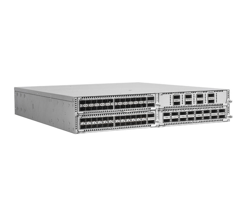

M-LAG/VSU/de-stacking for higher availability, PFC/ECN-based lossless RDMA network with high performance
four service slots, 25GE/40GE/100GE line cards
RG-S6510-32CQ32×100G ports
RG-S6510-48VS8CQNumber of IPv4/IPv6 host routing entries: 128K/64K
